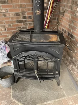

They are entirely different stoves. The IR is a wonderful big heater and a real beauty. It was made by Dovre for Quadrafire and has some excellent castings. The 4300 is a conventional large steel stove. Moderator Jags has an IR.
The issue with smoke coming out from the stove is likely due to negative pressure in the basement and not the stove. If so, a replacement stove would still have this issue. An easy-breathing stove from Drolet/Osburn, Pacific Energy, Regency might work better if draft is weak due this problem. Or, it may be helped by improving the flue system. Tell us about how the stove is vented from stovetop to chimney cap including heights, and chimney liner dimensions. Another thing that can affect the stove draft can be air leakage on the floor above the basement. Leaky windows, attic vents, etc. can cause negative pressure in the basement.
As for value, someone that knows this stove would grab it quickly. The stove looks almost new. Clean up the rust on the top griddle with steel wool and a little mineral oil. In Sept I would sell it for $1500-2000.
PS: I am wondering if the "smoke" was the paint baking in? If so, that will clear after a few hot fires that take the stove up to 500-600º. If you can do this when the wife is out of the house and put a fan in a window to exhaust the fumes, then the stove may perform well. Do you have the manual for the stove?

A central, interior chimney is good. The first few fires will be increasingly smokey, from the paint baking in. These should be done in a series of bake-in fires from just kindling, to say 4- 2" splits, to larger wood, taking the stove up to 250º, then cool, then up to 400º, then cool, then 500º. The paint won't really bake in until the stove has reached 500+º. Make sure that the bypass is open for the first 2 fires. Note that draft may be weak until it drops below 40 or 45º outside if negative pressure is present.

Storm ended and I took a walk out to the garage for the nut driver. The stove pipe in the basement came apart like it was new. Issue looks new too! The chimney is 6” round looking straight up I see daylight so it confirmed it’s a straight shot up. We have 3 flu’s this is the center.
I texted the neighbor, he didn’t know if he was there for first start or how often she used it before we bought. The manual was dated October 2010 and we bought in spring 2016, it was not in use whenever we came pre-purchase. It could very well be in need of paint burn off.

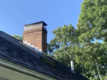

It should work fairly well unless there are negative pressure issues. Is this an exterior wall chimney?

I wasn't sure, the chimney picture looked like it might be on an outside wall.

I would do the same. The IR is a great stove. It was on the shortlist for our house, but it was too radiant for our corner install. The clearances didn't work out.

OP says it's 6"r all the way up. By the looks of the grates, this stove has barely been used. Maybe they tried lighting it on a mild 50º day? I'm hoping it's paint that needs baking and they can enjoy this beauty for years to come.

I’m with you on the paint! I didn’t get on the roof, it has been in the 90’s for a few days now. From the basement it looks like a straight shot there is no other access then the basement and the roof.

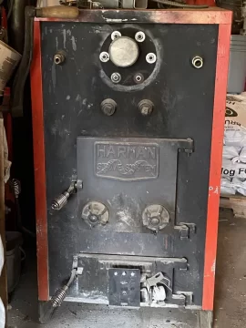

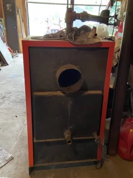

Most of my stove time has been actually with a wood furnace that dad just pulled from their basement. It worked quite well and I’m sad to see him switch to pellets. At 75 having the pellets delivered and feed every few days makes sense. My parents harman:
D263EC3C-C095-48DB-9113-345ECEFDBD3F.jpeg 48F408AA-0255-46DE-8CBE-DFB74995F407.jpeg
