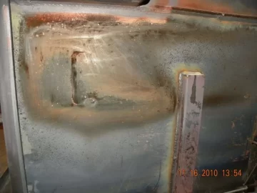

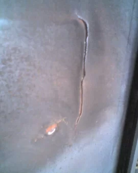

These are the cracks in the exterior sides behind the heat shield

Overfiring may warp a steel stove. Usually the top plate first. But those kind of cracks in the side of the stove body ain't from overfiring. That is a chit built stove. Probably cracked from the welds where the secondary manifolds and brick retainers are welded into it and weakened the steel.

Yeah, we can all figure that out here but the brain trusts at Home & Hearth Technologies are obviously much smarter than we are and they say it's our fault.

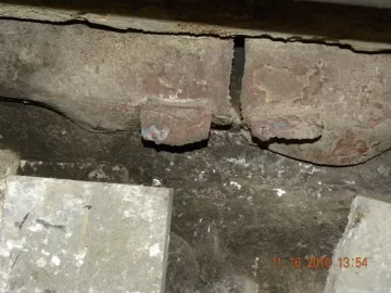

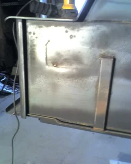

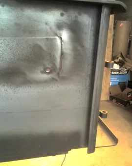

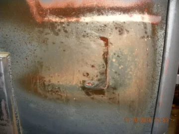

That is EXACTLY how the crack in my stove looks!!! Its funny how you mention the China sttel. The guy that inspected my stove told me the same thing..He also told me that Quad had issues with the cracks in the back as well and they were fixing them some how. He also said they had a quick fix for the older models that were burning off the firebrick tabs but the design has since changed which makes it harder to fix that without welding. The other thing I find interesting is my stove is an 05 model as well. I will be on the phone with them on Wed. morning to see what they have to say now. I now feel like I got scre### when I bought this stove. I did alot of research on it and found great reviews back then. I grew up burning wood in an old Alaska double door stove that just burned great. Never had an issue out of that old gal. Thanks again so much for your help. Heres a few pics..Looks just like yours..

Now I understand why there are so many class action law suits these days. My stove burns properly, no issues, but I would like to inspect it as well. I think I can remove the back shield but the side shield is tack welded to the front of the stove and bolted at the rear. What year model is your 5700? I can't understand why they won't stand behind it. Does the white ashen sides indicate overfire? If it did overfire it was likely because of the crack admitting extra air. Thanks for the pics.

Those cracks are Grade A crap. Don't let up. The tabs - overfire - maybe. The cracks in the panels - no. That is a design issue, not an overtemp issue.

Keep in mind that the tabs that are "melting" are about 3 inches away from those huge cracks you see in the sides. The crack on the rear tube was usually confined to the tube and did not break the outer plate of the stove. Usually being the key word.

Those identical cracks on multiple units spell design flaw. Possilby, the burnt off tabs are a symptom of the air leak torching this area. This is not overfiring, nor in control of the user. It appears to be a serious and dangerous problem that needs immediate attention.
