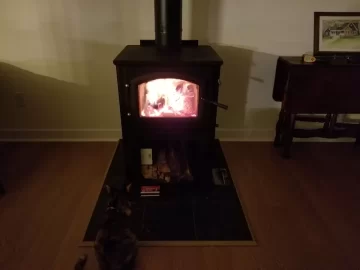

So far so good. Stove was just installed this past Wednesday (12/29) and yesterday was the first real fire we had in it (after the first two smaller tempering fires). So far I am very impressed by the design of the stove and happy with the purchase. Yes I was disappointed that there really isn't any reviews on this stove as it seems like a great option. None of the local dealers in my area even had any on display, so when they installed it was the first time I ever saw one. Let me know any questions you have, I'd be glad to answer as best I can.

Looks nice, it this on a porcelain tiled floor?
When you get a chance and more used to the stove, can you post a short review in the Ratings section? That will be helpful for future stove seekers.

No, this is ceramic tile over concrete. Ya I'd be happy to post a review probably in a month or so after I've had a chance to use it for a while.

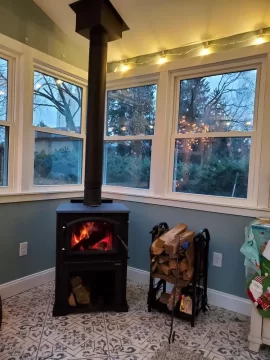

We love this this woodstove. Emergency heating for most of our house, and a cooking surface. Efficient and nice looking. One of the best and most unique features is the ability to slide whatever 12"x12" ceramic tiles you want, down each side, to customize and change the look whenever you like. We put tiles in the sides which match the large format tile we put on the floor and rear heat protection wall. Floor tile is on concrete floor.

That install looks great! I hope you’ve moved a bit of furniture in there since the pics were taken! I like the idea of being able to change the stove’s personality at will.

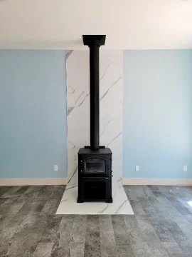

We just installed the Discovery 1 in late Nov. You'll definitely want no bigger then 16", which will go in perpendicular to the glass door. You *may* be able to go 16.5-17" if you put it in diagonal, which might touch the glass (I'd recommend to avoid this situation) but this will mean only 1 -2 pieces of wood will fit. If you do have longer pieces, you can cut them in half and then put them in parallel to the door for overnight burn.
I really like the stove and appreciate that the firebox is higher then most stoves. Makes it nice to cook on (heated boiled veggies and tomato sauces so far).
Seem to have hot coals every morning (10 pm- 7am) which is easy to start wood in the morning. I'm leaving a good bed of ashes on the bottom under the coals, pushing them away from the front air hole and door jam.
The lower automatic air control lever seems to bind and VERY HARD to manually move when stove is hot (300-500F flue temp 18" from top of stove). Not happy about that but not sure if it's normal or something wrong with my unit??
Still playing around with it to figure out optimal settings for burn. Seems easy to run "low" around 200-250F by only putting in 1-2 bigger pieces of wood, but wonder if that's making creosote ? I have a 22' class A exterior chimney. A bit more challenging to get it 400-500F stove top temp. Due to the limitations in amount of firewood it holds.
Gotta be careful loading the wood to not smack into those top tubes, and pick your sizes carefully to fit multiple pieces in the small firebox.
So far, pleased with the stove overall. Curious to see what you think of it when you get it installed 😁

Nice looking stove. Looks very European.
