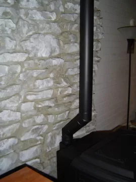

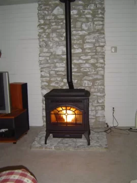

Reading posts here helped me immensely while I was doing research on stoves so i thought I'd do a review on what I decided on.
Location: Southern Ohio
House: @1,900 square feet wood siding 25 year old open floor plan. Two stories, had existing hearth pad in an area that's the living room/Kitchen/Dining room. Opens up into the stairs for the 2nd floor and sits across from a hallway that leads to the rest of the house.
Previous heating method: Forced air electric, very cold and inefficient (20 year old system), would run 24/7 just to keep the house 65. Previous owned had a propain stove but that was removed before we moved in this summer.
The contenders: Quadrafire Mt Vernon, Harmon XXV
I ended up deciding on the Quad Mt vernon. I loved the new features of the AE model, the programmable thermostat, larger hopper, self cleaning firepot, and being i was planning on heating my whole house with this i liked the higher (on paper anyways) heat output. I disliked the harmon feed method.

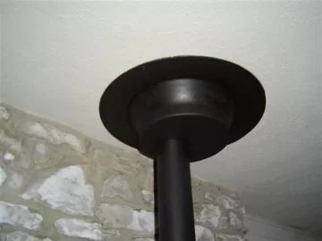

We had existing 8" stove pipe and chimney above the hearth pad and decided to run the standard 3" pellet pro pipe straight up that. I understand i could have used a reducer and just vented into the 8" pipe however i felt safer running the new pipe and being i plan on eventually burning both corn and pellets i wanted the stainless lined stuff to last longer with the corn fumes abuse.

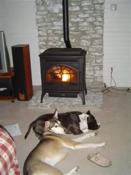

Congrats on your new heater. Looks good and sounds like it is heating good. It can't get better than that.
Thanks for the review. It looks great and appears to have the 2 dog night approval. I've been eagerly awaiting tests of the new design. How is the blower noise at medium? What speed are you normally running the stove at?
