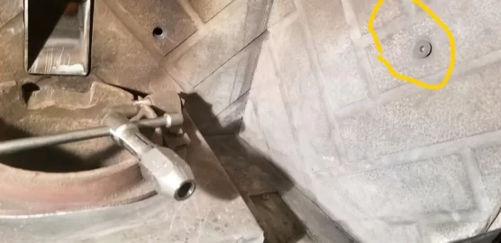

Screw in right side baffle is now stripped - just didn't budge. Used hand not drill. Used star driver and then tried clamp.
I wonder if I should just pry it off and order a new baffle.
Just concerned about where the screw inserts - if pried, that would strip.
Could drill a hole in the middle.
