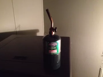

My ignite hasn't worked since day one ... I use handful of pellets in the tray and torch with lighter ... Works everyday and has never failed... Cheaper than new ignitor or board for it

Mine does just fine. Because of safety slip under the lid, I grab handful of pellets and put it in burn pot. With my stove the pellets won't drop if door open and lid closed, so ignite them with torch and close the door tight then pellets start to drop.... Cheap and easy and been doing this for years

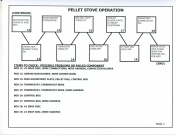

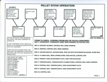

Here is the start-up sequence for Quads,which may help in figuring out where to trouble shoot:
