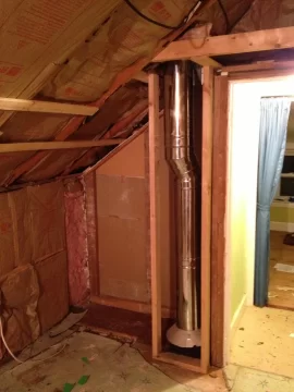

Hello all
I'm having my upstairs bedroom finished off. The contractor is boxing in the class A pipe and I noticed insulation around it and pretty much right up to it as it exits the roof (paper faced bats) and he knows about the 1 inch clearance, etc. Its only R13 insulation. I'm planning on telling him, but im wondering why there is a square ceiling box between the first and second floor which maintains the clearance from insulation but nothing required as it passes thru the roof between the rafters. I understand that the box is where the double wall connects to the class A but why nothing when it goes out of the roof where there is gaurateed to be insulation? Nothing to keep insulation away. What do you think guys? Is this a big deal or am I over paranoid?
Chimney is Excel, intalled 2 years ago by dealer and second floor was not finished off at that time.

Here is a pic. This place is a story and a half and built in the 40's. It is currently not occupied and I dont want to cut any corners, or have the contractor screw it up. If I had the time I'd do it myself so I know it was done correctly. As you can see, im talking about as it exits thru the roof.

He just needs to make a sheet metal firestop/insulation shield. No big deal at all, it will only take a few minutes.
Ah, this is on the top side. Definitely keep the insulation a couple inches away. I know Excel says 1", but I would prefer an additional margin of safety for anything enclosed in a chase.
Maybe line it with durarock? If it were me id sleep better with 2" clearance to durarock or sheetmetal. Im no pro though! Its open now so get her right!
Nothing special is required here. It could even be framed with wood blocking, then insulate up to the blocking. As long as it has 2"s around it there is no problem.

Yes, 2" to wood is fine. After all, your roof sheathing is likely just barely 2" away from the pipe as that is all the bigger they make the cones on the roof flashing.
