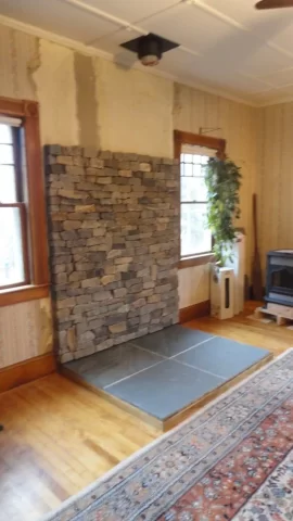

I just finished building a new hearth 4' deep and 5' wide. The backing is thin veneer ledge stone with a 1" air gap behind it
. My question is the Class A chimney is in place, but when I do the measurements my Woodstock Fireview is going to be 31/2" from the front. The manual says it should be 8". Can I get away with this or should I use 2-45 degree elbows to get the stove back another 41/2 " to total the 8". The pipe is double wall stainless and I'll meet the requirements for fire safety with the wall in back. I think I know the answer and that's get the two elbows, but I wanted to pass it by all of you smart folks with way more experience.
