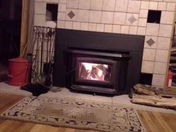

Did this 15 years ago, never got around to putting the grates (still have them :) back in for the heatalator system .
