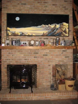

I remain totally happy with my F600. A couple of quick points: Front loading is not really an option because of the ash spill problem. I always load from the side and don't open the front doors at all during the burning season. The interior geometry of the firebox does limit the amount of wood that can be put into the stove all at once. With a bed of coals, the interior space is even more limited. I have never been interested in "packing to the gills" so do not find the limitations a problem. If adding lots and lots of wood for very long burn times is important to you I don't think the Firelight will be much, if any, improvement over the Oslo. I'm not sure about clearance to flammables above the stove, but I don't really see why/how they would be less than the Oslo's.
