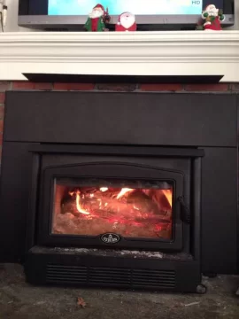

Ok I was reading this morning that people were running stove hard today. Does this mean they are leaving air open more than usual? On EPA stove how do you run it hard. I thought the sooner you can get air down the better? Does leaving air open produce more heat or send the heat up flu? Just curious. Right now house is doing ok. Wouldn't mind seeing better if I could. I'm running same as I do every day. FYI. Osburn 2400 is the new insert still have not changed my info lol a
