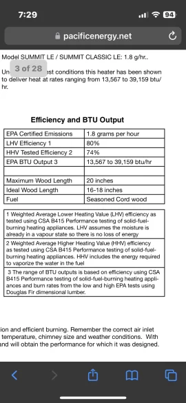

This is what my stove says
[Hearth.com] Do you lose BTUs if you run your insert wide open?

So it's different for different stoves, as expected.
Blanket statement one way or the other cannot be made.
