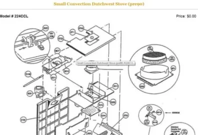

The first issue is in regards to the fit-up of the catalytic combustor.
I am trying to determine whether this circular perforated cast plate below the combustor is suppose to be there. It does not appear to be in the exploded parts view. The catalytic combustor does not seem to fit properly (I suspect because of the room that this plate consumes), the thermometer (1" probe) also contacts the catalytic combustor as well which does not seem right.
Could you please look and advise if you are familiar with the stove. Any wisdom would be much appreciated.
