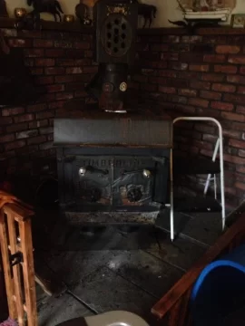

we bought our house 20yrs ago and it had this stove in living room it is massive and has served us well, heating our whole house 2200 sqft 2 yrs ago my hubby bought this magic heat and attached to the pipe to help reuse lost heat he said and it had a blower so worked even better! At end of last season the magic heat was getting stuck a lot and we started getting more creosole my husband was constantly cleaning this year when we got a big rain storm water started coming down our pipe into and on the stove so he checked it and said the pipe is rotted in the attic and the pipe on roof the flange was leaking he tarped so to tsp water damage. He went looking to replace pipe and everyone is telling him we need a new stove but honestly we really can't afford it right now , I say replace the pipe and repair the roof and keep the stove. they all tried to sell him these new ones and say they are so much more efficient but i found that this one is about 45 % -50% on one of the sites and the new ones are 70-80 and use less wood, but my wood is free and i have the stove why get a new one, the new ones that could heat our size house are around 3800-4000 dollars , the piping and roof pipe and installation is 1800.00 that is doable but I really don't wanna spend 4000. my husband says the new ones are more efficient and burn less wood but my wood is free so who cares i don't mind loading it more. I do however want it safe and don't want a fire or anything dangerous. the timberline is double door on like pedestal that looks like 2 pipes. it has mountain tree scene on it , it is large and nice and we have a slate floor under it and brick behind it , it in a corner and each side wall has brick , mu husband said there is a piece of steel on the back of inside of the stove that was covering the bricks that is bowing in and thats the only thing that scares me about the stove, is it safe to continue using , can that piece be easily replaced? My husband is handy but doesn't feel comfortable installing pipe or messing with fire stuff so i will have to pay for installation of anything we do as well as what we buy. Please help, any advice is appreciated. if we spend the money on the 8'' pipe repair and install of new pipe for this stove will the stove last us another 10-20 or even 5yrs?

Make the chimney right, at all costs..... So long as that stove is installed to safe measures (NFPA 211 guidelines) then keep going at it.
If you have free wood, and easy access, and don't mind splitting the extra a new stove might save you, then keep at it. Again, so long as things are safe, then it's a good deal and that is a solid heater.
I don't know what your current plans are as far as cutting and splitting wood, but with a newer stove, to get the benefits it has to offer, wood needs to be drier than what many of the old stoves would chew through. This means that for many hardwoods, they need to be cut, split, stacked, in an airy location for at least a year (some like oak 2 years) to be able to burn less wood and get the same heat.
I did this (got myself 2+ years ahead on wood and made darn sure it was dry by being cut, split, and stacked that long) and went from burning 5.5 to 6 cord a winter down to about 3.5 to 4.5, depending on the winter.
In all, no matter what you do, my opinion is that the magic heat reclaimer needs to go. Do a search of it on the site and you'll see my opinion doesn't stand alone. The problem is that a chimney system stays clean when the flue gasses can keep warm all the way to the top of the chimney. When you install a chimney heat robbing device, it lowers flue gas temps and increases your ability to accumulate creosote and have a chimney fire. At the same time, reduced draft in the chimney, from a cooler chimney, can have a negative effect on the burn in the stove, amplifying the problem.
In all, if that stove is installed correctly, and the chimney is made safe after what you found this year, then keep doing what you are doing, just ditch that chimney thief.

if money was tight fix the chimney and make sure everything is safe i had a magic heat on a timberline is worked great and i swipped it everyday to keep it clean and clean the chimney EVERY month honestly i think magic heats are illigle to use in ny where i live but i used one and loved it the epa stoves are the way to go if you are 2-3 years ahead my wife lifes loading the fire she thinks the wood splits and stacks itself
Can you post a picture of what is warped (bowing out)? Very few newer stoves use 8" pipe so keep that in mind as you'll be spending extra money now, when in the future if you do upgrade to a newer stove, you'll only need 6". You say you get the wood free, so you don't mind using more. Does your husband feel the same way? I'm assuming he's the one doing the cutting, splitting, stacking. Without seeing a picture of the problem on the stove, it's going to be hard to say whether or not it's safe to continue to use. If it were me, I would bite the bullet now as you need to replace the piping anyways. You should be able to find a suitable replacement in the $2,000-$3,000 range.
i had a 6 inch chimney that i enlarged to fit the 8inch flue and worked fine if your replacing the chimney i would deffent get a 6 like claydogg said
Agreed. At first read, I was thinking a fire brick retainer, as you mention bowing in, and often if it's the stoves outer wall, I see them bow out. Regardless, Clay's advice is right on, pics make a different. If possible, use a straight edge to help see the problem area better.

What about the bowed piece in the back of the inside of the stove should that be replaced , and you feel the stove is safe to continue with as long as we get rid of magic heat and do all new pipes? I uploaded a pic of the back of inside of stove the piece bowed is a piece of I guess steel that lines the inside of the stove and holds brick up i guess? What should the new 8'' pipe and flange and chimney cost 1800 is too much? That was the price given by a company in business for 20 yrs with A rating, how do I know who to use, I also wanted it done asap because I don't want any wear damage or mold. Do we need stainless steel pipe or can we go with the duravent pipe i have seen which is cheaper , the pipes we have now are the old ones that were there and they lasted over 20 yrs so they can't be that bad right?

That appears to just be a piece of steel that retains the bricks, but I'm not certain. Did you have any professionals check the stove over? I feel like that is necessary at this point. With that one piece being so badly warped I'm wondering if anything else is. Does the back plate on the outside look straight? You don't need stainless inside the house but it's impossible to say exactly what you need because we don't know clearances.

It would be better if you had someone actually come inspect the stove in person, not just pictures. Did you look at all exterior walls of the stove? Check them with a flat edge to see if they are still true. Did you ask the installers the price difference between the 6" & 8" pipe? I imagine it is somewhere around $400. How big are your splits? Chances are they are in fact going to be a bit too large and possibly wet for a newer stove as most will have a smaller firebox than you're used to.
they want 100 to come look at it, exterior walls i just checked with a straight edge and is straight, yes there is about 450 difference , his splits are 16-28 so he will have to cut some, and they definitely are not bone dry because they are stacked in a homed wood shed with no doors so one side does get blown in at times and our stove is 30 wide and the firebox is huge, so will this wood ruin one of the new stoves? this stove puts out enormous heat quite often its too warm in there for some people because its not a open concept living room, we have an central air exchange right outside that room and we put the fan on and it circulates the heat all over the house , we both do like the look of it too, its real solid . i just don't want to keep and put all new 8'' pipe and then it go on us and then we have to get all new everything. i would like to keep if i can id raher spend money on opening up wall to make more open concept. and that my husband feels comfortable doing himself.
when we bought house they had co's and all paperwork on install so for this stove at the time of install the clearances were right, all the places i went to said the new stoves require less of clearance and since we have brick on surrounding walls its fine. A new stove we could afford would definitely be smaller in size inside and out
I can't say for sure about your existing stove and it may be worth the $100 to have a professional check it out for you. I can say that if your husband is a handyman he can most likely do the pipe install himself with a little help from a friend. The savings from doing the work yourselves, as well as using 6" instead of 8" would surely offset the cost of a new stove. In the end it's up to you. I loved my old Vermont Castings stove and I installed a brand new SS 8" liner because I wanted to keep it a few more years. After moving it around to install the pipe I ended up cracking it around one of the legs. At that point I just bought a new stove and wasted a about $400 because the new stove only needed a 6" liner, not 8.

posted a pick it looks like its a steel fire brick retainer , i checked all three exterior walls and they are straight no damage
