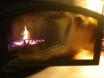

I'm new to inserts, but recently had a Quadra-fire Voyageur installed. It really puts out the heat, but so far I'm worried that there is definitely something wrong. Here are the things I've noticed:
1. The glass is very VERY hard to keep clean. Within about an hour it starts to get some spots on it, almost always one at about 1 o'clock, and another at around 10 o'clock. Sometimes by the end of the day it's very dirty. I would have to clean it every day. I'll attach a picture about it.
2. I notice that I almost never get those secondary combustion type fires -- the rolling flame kind of fires that I see in everyone else's inserts or stoves.
3. There seems to be excessive ash left over.
4. I notice that moving the air intake or the burn valves don't seem to make any noticeable difference to how the fire is burning. Shouldn't I see something when I move the knobs?

  • [Hearth.com] Questions about new Quadra Fire Voyageur Insert
First off welcome to the forum.
How did you check your wood moisture? Sounds like you may have just stuck the mter into it. You need to resplit a piece then check on the freshly exposed area.
Ash is good, excessive unburnt wood is bad.
If your wood is good, I see a dollar bill test in your future.

This all screams wet wood.

Just the sight of that glass screams wet wood and/or poor burn temps.

So today I went out and got some kiln dried wood as suggested, and same thing happened. I'm at a loss. I'm ready to give up this insert. So... last ditch...
Is anyone willing to post what their window looks like after a day? Perhaps I'm being unreasonable. I would like to see what other people are seeing after a day. I'll post on another thread, too, to see.

What temperatures did you get? What did the fire look like? What were your air controls at?
Mary - Are you relatively local to Halifax, PA? Maybe I could take a trip over and give you some tips on operating the unit and make sure that everything is normal with your unit.
In another thread she seems to have figured it out. It was a combination of new to stove burning and warm weather/poor draft. On a colder day it burned well with cleaner glass.
Important Note: The outside air cover on the right side of the unit has to be removed prior to installation on the Voyageur. You even have to do this if you are NOT installing the outside air kit.
All of the complaints to us about heat were a result of this not being removed. It is kind of stupid because in the installation instructions, it tells you this under the "optional outside air kit" section in the instructions (which you would never read unless you were installing an outside air kit). It says:

Thanks for this forum; it's hard to find objective opinion on this insert. I too, have a Quadra Fire Voyager and I'm only mildly satisfied with it. First, Mary is NOT off-base with her assertion that it is woefully short of air supply. I have been burning wood for some 45 years now with many different types of wood stoves AND wood. This one needs air, short and simple. I have freshly stacked seasoned (over two years) dry wood; mixture of cherry, ash, red oak and tamarack(larch). SEASONED WOOD!! That's to all you folks who think they are the only experts in that arena... ;-)
If I leave the door open slightly, everything goes along swimmingly, hot fire, great heat, minimal glass staining ( a problem, though). If I follow directions with this insert, I get a smoldering, smokey mess, with both controls fully open. BTW, Mary was right; the controls are utterly useless...
The glass is really a problem... I find I'm cleaning it daily, with really strong stuff too. Rubber gloves, eye protection and respirator. Not what I want to do every day.
While I don't think this stove is a clunker, it needs to go back to the drawing board. If it truly wants to be a heater when it grows up, it needs some AIR!! I also love the overstated referenced cautioning to "over firing" of the stove. That cries out: "I have really cheap, fragile components!" Since when can one not have a good old fashioned blaze in a fireplace? Isn't that what it's for? I'm sure that comment will draw attention...

I wish I'd seen this pic before buying this tonka toy! Mine looks the same, and I burn ONLY dry, seasoned firewood!
