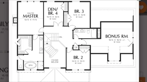

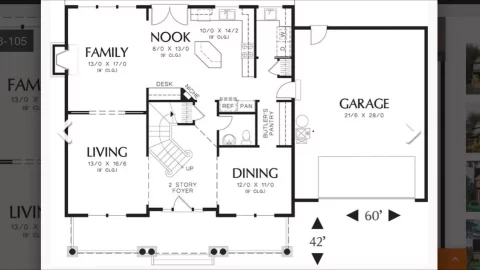

Thanks so much for taking the time to read. Here are the floor plans. The ceilings on the lower level are 9 foot high and the home is well insulated with foam insulation and double pane argon filled windows.
I'd love to hear any suggestions you have, especially if they are lower cost.

Good insulation is a good start. As long as the wood is nice and dry all the way through you should be able to heat the place with the fireplace. The furnace may kick on once in a while if it's -20F and blowing 50 mph but that is no big deal.
The Valcourt Lafayette, Flame Monaco and Pacific Energy FP30 come in at a lower price usually. The FP30 is based on the PE Summit's 3 cu ft firebox. Get a quote on a Heat & Glo Northstar and an RSF Opel 2 or 3 too.
