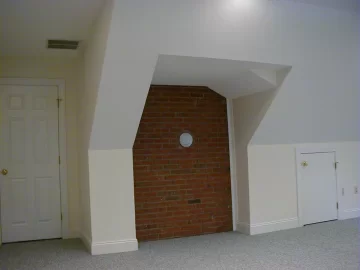

    I would like to do just that. As in the above photo, i have a brick wall behind the stove and would like to bring outside air through the 7" thimble plus have 3" vent going out through the same 7" thimble and not be DT all the way.
    Is there a fitting that will accomplish this?
    2" flex from the top of the chimney all the way to the back of the stove plus 3" exhaust going out.
