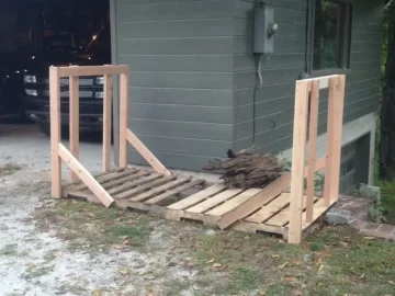

I built this on Tuesday out of a couple pallets and a few 2x4s. The pallets are not joined, so I can move them to areas of my yard where I let my wood season. Essentially they are bookends, so add'l pallets can be added to make the stacks as long as you'd like. As it sits it is 4'x3'x8'
For now I needed some extra storage for to-be-burned wood. This will be the first wood to go this fall.

what a good idea - simple 'pallet book ends' coming my way.
Reactions: AnalogKid
Mini version of pallets Pete's racks which I copied, nice that you can move them around.
Nice. Looks real nice and handy in that location.
Nice - and you split by hand and split rather small - impressive!

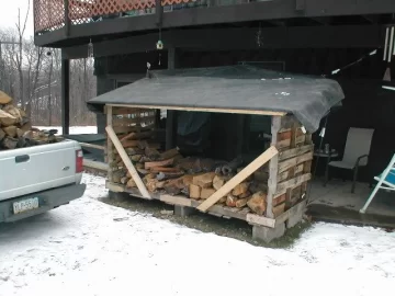

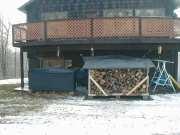

Been doing this for years. Works very well. I even made a few pallet "cages" for odd ball sizes and chunks.
Very nice!
Simple.
Pallets instead of 2x4's on the ends works nice also.

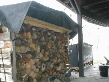

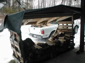

I used to make my wood manger out of this set up, then slide a 2x4 between the two bottom pallets front & back and connect them with the 2x4.
Then framed a 2x4 frame laid across the top of the upright pallets, and then put plywood and a tarp over that. Instant wood manger.
Then break down and put in the barn for the off season. Held about a cord
Flap tarp up to load, then flap tarp back down after loaded and bungie down.
Now I just stack 3 or so cord on the back porch.
The tarp over the wood manger, is now laying on top of 1/2 the deck behind it, and now I just stack a season's worth of wood on pallets under the deck on the porch there.

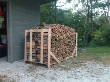

That's exactly how I store wood in my garage when burning season comes around. I just moved it out of my garage.
Yours looks a bit nicer than mine, but it gets the job done.. Nice work.

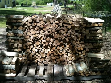

[[Hearth.com] Quick and easy rack I like the book end idea . I can't build a shed until I finish clearing . I need something portable , and I already know how I will convert this to a shed. I had left over stain so I used it ... Maybe overkill Link Removed
It's all ash I have several more dead ones to take down... That is all for this season . I plan on covering with a roof when I fill it ...
