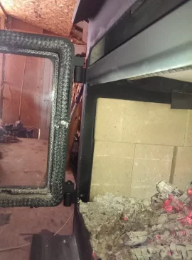

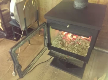

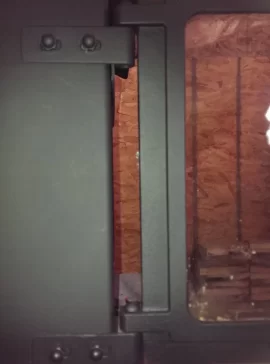

How far does your door open and does the door rub on the bottom hinge when the door is open? Other than that the stove works great and i can't be more pleased with it. Tech is going to resolve the issue if i still have it after trying to adjust the hinge a bit tomorrow, just curious how everyone else's is working.

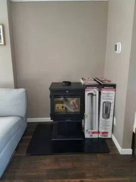

I just got mine. Haven't burned anything yet but the door opens 180 degrees. No issues opening all the way. No dragging.

Looks like maybe a casting or finishing defect on the door casting... IMHO, if ESW didn't send any touch-up paint I would call them and see if they will send you some and just take some of that "interference" out with a file/grinder/etc then touch up the paint...
