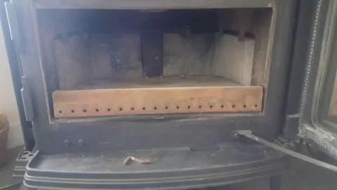

I've been putting off cleaning the flue. My gut feeling was that it was ok. We only burned 2.5 cords last year and the wood was nice and dry. But today was quiet so I got out the Sooteater and got to work. I picked up some 3/8" stove gasket over the weekend to make a custom baffle gasket too.
All went well. I cleaned out the ash first. The firebrick is still in good shape. There's one cracked brick in the rear which I'll watch but it appears to be holding together for now. I know exactly it happened too. It was an oversize piece that I was trying to squeeze in on a hot bed of coals. Moral: Don't force or slam wood into the back of the firebox! The baffle is fine too. Looks like a simple cleaning.
