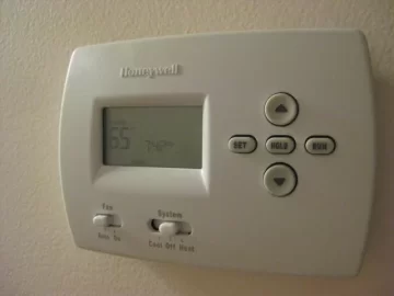

the thermostat i have comes on a few times per hour even at temp for some reason
So the thermostat itself calls for heat even though it keeps displaying the set temp?

what thermostat do you have? if it is the honeywell that senses wall and air temp that might be why it is coming on at random times. if it is the round type made by honeywell that is new (no mercury ball inside) junk it and get a different type those thermostats have a mind of their own and it's not a good one. if it is the old round honeywell that has the mercury ball those are the best. lasts for about 50 years. also if it's old check to see if it has a heat anticipater if so set it for 4

So, if the temp is set to 65, the heat will come on and run until 65. i think i didnt give it enough time to turn off as someone stated above, it might turn off .5 degrees higher to avoid short cycling.
once it turns off, even if the house is still 65, it comes on 2 to 3 times per hour. its one of the thermostats where you can press two buttons at once to get into the 'advanced settings'. one of the settings lets you choose the number of times it does this.. but there is no 'zero' setting.
took forever to find the instructions: (page 8-9)
https://customer.honeywell.com/resources/techlit/TechLitDocuments/69-0000s/69-1849.pdf
My settings (if it makes sense):
(first number corresponds to the options on Page 8 / Second number is your actual setting for that option)
1 0
5 5 <-------------- ? should i have this at '1' :eek:
9 3
13 0
14 0
15 5
70 Test
The setting in question is Number 5: Heating cycle rate (CPH: cycles/hour):
These are the options...
5 For gas or oil furnaces of less than 90% efficiency
1 For steam or gravity systems
3 For hot water systems & furnaces of over 90% efficiency
9 For electric furnaces [Other cycle rate options: 2, 4, 6, 7, 8, 10, 11 or 12 CPH]
..I have mine set to #5. But it allows me to choose Other cycle rate options. i can choose 1,2,3,4,5,6,7,8,9,10,11,or 12
should i just put it at 1 so that it cycles only one time per hour?? (if thats what this setting even means)
Sorry for the confusing post. looking at it in person its straightforward, but im sure its confusing for those looking at a jumbled mess of words and numbers :eek:
I would try it at 3 for a bit and see how that works out.

sounds like it is trying to keep the boiler or furnace warm so when it calls for heat it can go right to work. my opinion is how ever many cycles it turns on for without it calling for heat it's wasting fuel. i'd set it for 1 so it's not coming on while you have the wood stove running
