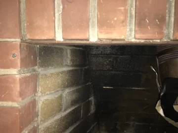

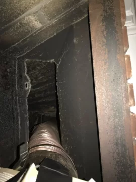

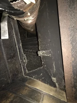

so I have a progress hybrid sitting in my garage and a mason coming to install stone over my existing brick fireplace and after a lot of measuring I realized that with my hearth pad being 1.5”, the exit flue is going to be about 2.25” too high to fit through my fireplace! I don’t want to use the short legs and I’m set on the ash pan. I’ve read a lot of forum posts on raising the lintel. My mason is coming tomorrow to look at what we’re dealing with but I’d like to get your advice as well. I’m posting some pictures so you can see but basically I think the lintel is the piece of angle iron right under the first course of bricks. Then there is the flue. Will it be possible to raise the lintel 3 inches? Is it going to be really expensive to do? Any advice or tips would be greatly appreciated.

Yeah it can be moved. While your at it i would cut the damper frame out and try to get the liner back to round. Then install a blockoff plate.

Yes all of that angled metal is the damper frame. It should have been cut out initially instead of smashing the pipe down to fit through.

For us to move a lintel up it would cost between 500 and 1000. In your case because it will be covered with stone after the fact it would be on the lower side for sure.
Thank you for the expectation. Will we have to remove the whole metal framing in there?
No just enough that the liner fits. Becausecyou will be covering it i would put the new lintel on the face making it much easier
What do you mean put the lintel on the face? Doesn't it need to be under a course of bricks for support? Do the bricks need to be supported while the lintel is removed?
In order to get a new lintel in on the inside the way it is now you have to take the top of the firebox down to make room. Because you are putting stone on the face i would cut a groove for the new lintel on the outside face and slide it into place. Then cut out the old one and remove the brick below the new lintel. I would do the same if i was putting it inside but would pull the one that is outside after sliding the new one in from the back.
Is the firebox the metal frame that is in there? And currently the lintel is angle iron ( I think- can you see in the pics?) I don't think the angle iron will fit through the groove right? What would you use to cut the groove?
The firebox is the yellow brick inside. I would use a masonry blade in a circular saw to cut the groove. And i would make it big enough for the angle to fit in
Reactions: Googs185
So the mason said he can do it but he wants me to angle grind the damper and frame out. What kind of person can I call to do this? If we do this and raise the lintel will we never be able to use it as a fireplace again? The mason said no but there must be some way to add a damper again in the future.
A chimney sweep can fix the install. And yes you could put a top sealing damper in if you ever wanted to go back to an open fireplace. Or if it is cut nicely it could be repaired. But the added height may cause smoke issues
