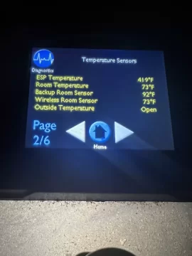

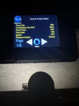

I put one fan on the floor by the dining room blowing into the family room and then another small six inch fan I picked up, that is supposed to be used as a desk fan on the other side of family room sucking air out. What I’m also wondering is how to set this thing up? I have it on feed limited to 60% on constant burn. Is this Ok?
These are the constant burn settings, Or should I use the remote sensor and turn up the temperature? The family room is 30’x18’.

Constant burn will burn at that setting continuously no matter what temperature your house is (hot or cold).
I would switch to the room temperature mode and pick a temp that works everywhere in the house. The room with the stove will be the warmest, and the bedrooms will be cooler (which is the way I like it anyway).
If it has a way to disable the ignitor in room temp mode, do that. Then the stove will get the room up to temperature, and then go into idle mode, where it just trickles to keep it lit. The fan will kick on and off and pellets will feed based on the temperature of the room, but the stove will always be hot and throw a lot of ambient heat. It does a much better job of heating the floors and walls and everything than on auto ignite that kicks on and off all the time.
