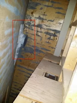

What's that? Is that still open to the chimney?
Its capped.

Make sure the cap is sealed tight. Any leakage is going to dilute draft.

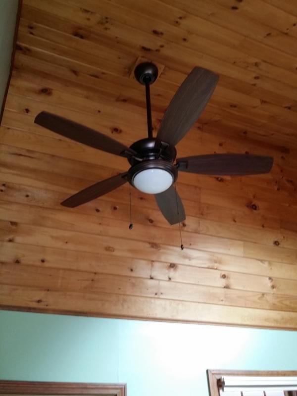

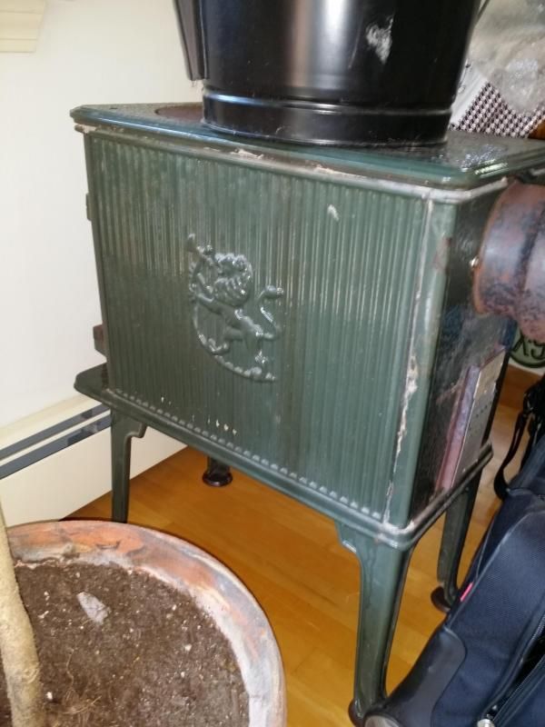

That would be ideal however, it will not be for some time. In the next few months we are getting geothermal put in for most of the house hence, the new stove on this side. On a side note, i have discovered something else unexplained with this house. I just installed and new ceiling fan today, same room as the stove, and i could not find a breaker for most of this side of the house. There are two breakers, one main and one sub, but none cut the power off. Only if i shut the main off did i not have power in that area. Now i'm no expert, I.T. by trade, but i don't get how this is possible. I checked for other boxes but could not find any. Anyways, here's a pic of the new fan and one of our old jotul from around 1980, thought you guys would enjoy seeing it. Thanks again guys/gals.
Not hooked up, in case anyone was worried about clearances ;lol

The little 602 is a much easier breather. It has no secondary air plumbing.

The one BIG issue he saw was the thimble behind that wall. He said that should be bricked off as if there was a chimney fire it would be a real hazard. I'm a little blown away as i though i would have to do a lot more/there was a lot more wrong. I'm still kinda at a loss.....
Yes, that is why I asked about the clean out. Any air leakage is going to weaken draft. Same for the seal on that capped take off. You can make a gasket for the clean out by using a good silicone sealant like GE Silicone II. Run a generous bead around the door rim then close it. Let it set up for the recommended time.
