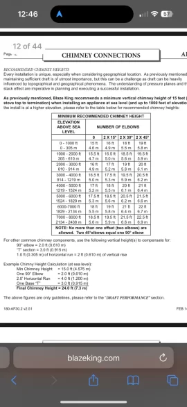

Probably more like 22’ from the blaze king manual.

BK states minimum is 15’. I have not seen any stove below 12-13’. I’d rather have the extra length and double wall to boot at 10,000 ft.

This chart is calling for 23' straight up flue at 6,000 ft altitude.
