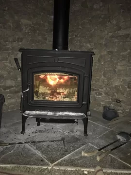

Looking at your first pic - my experience has been that my stove doesn't like less than 3 pieces of wood in order to burn well and I bunch them up. It seems like the wood burns better when in contact with each other.
I'm heating an entire house with mine so it's rare that I don't pack the stove full to the top.
Knots , How hot do you let the stove get? What stovetop temp do you try to maintain? My coals were manageable this morning. But I got up 30 minutes earlier to have time to fiddle with them.

Ive got a Rangeley... and it does coal a bit as the winter progresses. Dont be afraid to pack the hell out of the stove on normal runs. As other have said, let it get ripping and start moving the air closed as soon as you feel its right. I dont think I even leave my primary air at 25% when all is done. I close it all the way, and then move it back about 3/4" of an inch. I normally cut the air to 50% around 350, then another 25% at about 450. Ends up around 500 and burning happy. Good luck, I think its a real nice stove.
Reactions: Knots and jotulguy
75% open. Will do. Thank you
Here's the most likely issue . . . closing down the air further (I find draft and how well seasoned the wood is makes a difference on how far down you can close the air -- most of the time I end up shutting my air control all of the way and at other times I leave it 25% open) should result in more heat, wood burned up more slowly and those gorgeous secondaries . . . and if you burn in cycles you should see a reduction in the amount of coals.

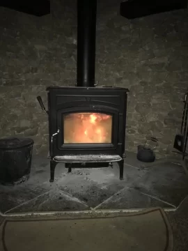

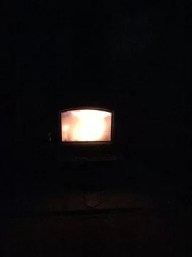

Thanks everyone for your help. Filled the stove got a good fire going. Shut the primary air down to less than 20% open and watched it happen.

Got to close the air down more. As it is being run a large amount of heat is going up the flue. The glass will self clean when the stove is run properly. In the picture I don't see much secondary burn. Turn the air down until the flames get lazy. At this stage of the burn that may be 80% closed or more.

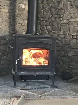

My air is about 25% open with this picture. I think I'm gaining temp. If I close the air much more I start to lose temp. Stove is at 450.

25% may be fine for this wood. The stove top should continue to gain temp. It will do this a little slower because the wood is loaded E/W. This blocks the air through the load of wood. If you want a faster, hotter burn, next time load it N/S. You may be able to turn down the air a little more with that loading. Another benefit of N/S loading is that you can pack the stove fuller without worry of a split rolling against the glass.
