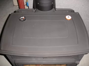

The F55 manual says the optimal temp is 400-700 F in the positions shown in the attached pic. Below 450 the burning seems to be inefficient and stinky. I try to stay away from 700. It feels like it's pushing the stove a little hard. I like 550-600. Like yours, I have no smoke when it's up to temp and just a heat signature. I clean my chimney at the end of season and get a half cup of dry dust.

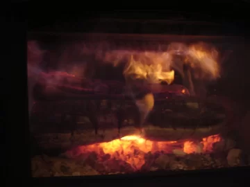

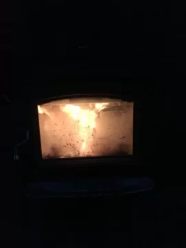

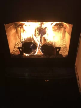

As always, pictures are helpful if you want feedback. Take some of full loads, before closing the door and at various stages of the burn.
I must have hit the button too many times. This is 2 pieces of dry maple . No bark. After burning down the coals. Stove temp 225. I opened door to take photo. Air opened fully.

Primary air closed about 25%. Stove temp up to 325.
Do you mean the air was turned down by 25% to 75% open or to 25% open? Tomorrow try 4 logs and turn down the air further if possible.
