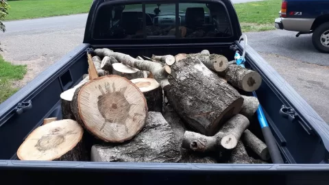

It has been a great truck. I've used it for hauling firewood, did fine loaded up even though it's a 4 cylinder.
