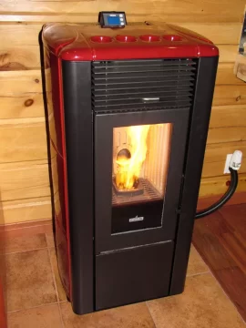

If there is one issue with that stove is that it is too d*mn hot! :) I have a house very much like yours, size and up-to-date insulation, and the Monica is overpowering unless it's below 15F outside. My stove is on the first floor, not basement.
As you know, the look is definately not the traditionnal black stove. If you have an horizontal venting, the absence of a visible flu pipe is only adding to this clean and modern look, if you're into this. Low clearance means that you don't have to leave 18 inches of space from the wall.
The stove does needs the weekly 15 minutes cleanup, but I think my pellets are on ashy side. It's my first season, so I have no comparaison with other pellets. Another minus is the hopper only take about 30 lbs, so a whole bag doesn't fit in. The auger motor is cycling on and off to modulate the feed rate. In the grand scheme of things, I think they should have used a variable speed motor that turns continuous, as I find the intermittent motor to be somewhat annoying.
After installation, my unit had a few instance of spurious vaccum-related error-codes being thrown at startup, but holding the power button a few seconds resetted the error and the stove was just fine afterward. It has not done it for the last 2 months.
Good luck!

When you say 'auger cycling on and off', does this make a noise and use more electricity?
I notice from your pic, that your mains cable isn't using a plug to connect to the wall socket
Yeah, kinda. More like a faint hum sound, about 2 seconds every 8 seconds. I measured the electrical consumption and it did increase when that motor is running. My power cable and its connector are totally stock and common, but they are covered by a split loom, because my cats have the bad habit of chewing on every cables they can set their teeth on! :rolleyes:
Try cayenne pepper on cables etc. Trying to use a variable low hp motor gets little to no power so have to use a good bone crushing on off motor.
