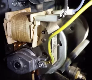

The exhaust fan in my Ecoteck / Ravelli Elena looks like this :

Pelleting in NJ : That looks like my replacement fan - is that a nut in the middle holding the blade in place ?
Lake Girl : You could well be right : but not with the force I've dared to use up to now !
I'm hoping someone will recognise the 'extra' ring in the middle and tell me what it is.
I suspect its a form of Woodruff key / wedge as I can feel a 'flat' on the actual axle with a very small screwdriver.
IIRC, there is a nut holding the blade on the "replacement". What year is your stove? Must be an earlier version...

We have been selling the Ravelli Ecoteck models for five years and all of ours are the earlier models with the ball bearing EBM Pabst motors. If you have a question, the Stove model and year is needed and a picture is helpful so we as technicians don't waste our time trying to figure out what you have setting in your living room when we are a thousand miles away and you are 10 feet. I will help if I can!
Thanks for the comments lowcostheat, I realize I didn't provide any input on my issue. I have a (broken link removed to http://usa.ravelligroup.it/prod/34-francesca_.php), 1.5 years old. It is a similar fan to what Doug has, and a similar issue with it not rotating smoothly (it would stop as soon as I stopped pushing it).
I was able to find the blower online, EBM Papst QLN65AC Series Crossflow Blowers . It was straightforward to remove the motor once I took the side of the stove off and convinced myself that it was OK to pull hard after watching this video - How to flip the motor on a crossflow blower. Once I had the motor and fan out, I lubricated the bronze bushing with some 3 in 1 and a little bit of PTFE paste that I happened to have around. When I reassembled it it spun much better, but nothing like in the 2nd youtube video where he spins it at 3:05 mark and it looks to spin with no friction. I could spin it for maybe 2 revolutions. I didn't clean the shafts well, if I take it apart again I will. Attached are some photos.
