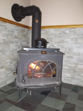

It doesn't happen often -- maybe 3-5 times a year -- but once in a while my stove starts getting hotter and hotter and the only way I can slow it down is to fully or partially block the secondary air hole with tin foil. It's not a big deal for me when I'm home, but I've been thinking that adding a damper a) might be easier for my wife and b) I might be able to get longer burns.
Not sure how I can easily do this though. Set up is as follows: Adapter to double wall pipe and then out through the wall thimble. I've seen that ICC sells a damper for double wall pipe, but it appears to me that this would give me another 6 inch rise in the stove pipe . . . which would not work.
I'm guessing there is a very simple answer here . . . telescoping pipe? flue sold at a different length? a method to install the damper in the existing double wall pipe?

For double-wall connector usually one has to add a factory damper pre-installed in a 6" section of connector. You have it correct Jake. In this case it would mean replacing the current vertical pipe with on that is 6" shorter or with a telescoping section.

Thank you for the confirmation . . . just wanted to be sure I wasn't missing something.
