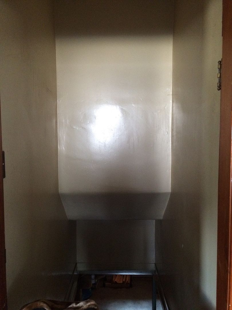

So this is the basement stairwell. If the basement light was on you could see the BK pedestal. You can see some splits.
[Hearth.com] Re-model :: Seeking more heat

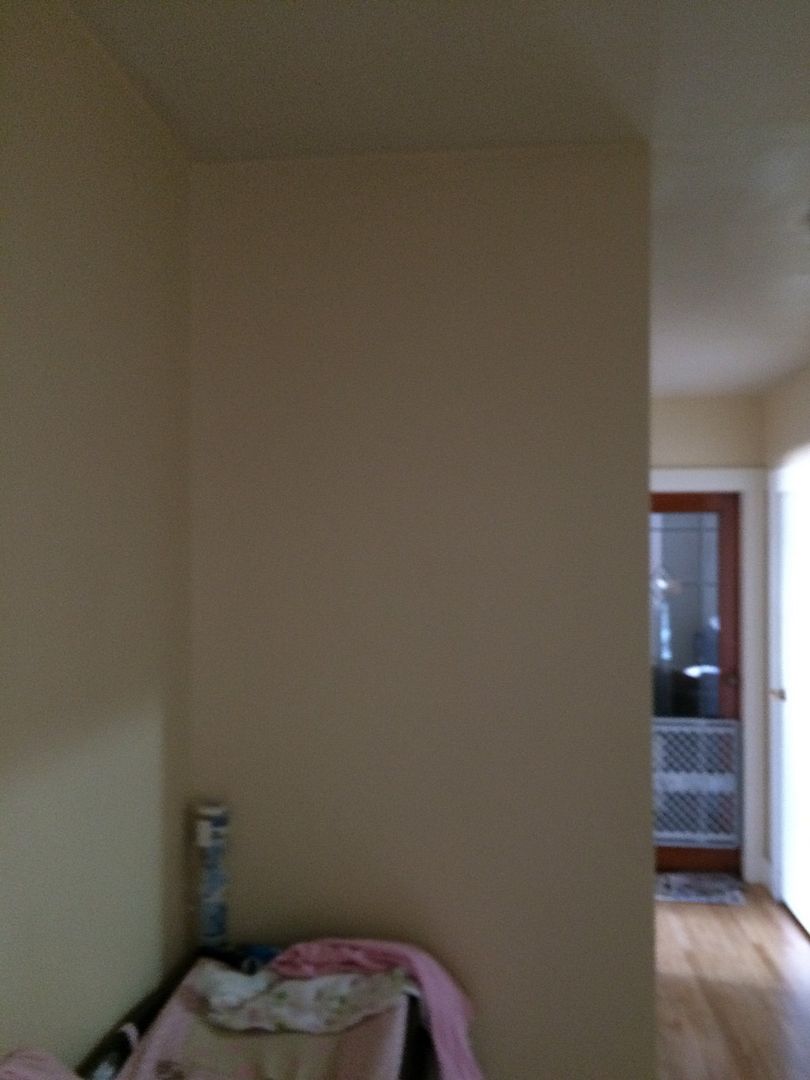

The bulge is a storage cuboard on the hallway aside. The access between the living area and the 3 bedrooms / bathroom.
This is the other side of that.

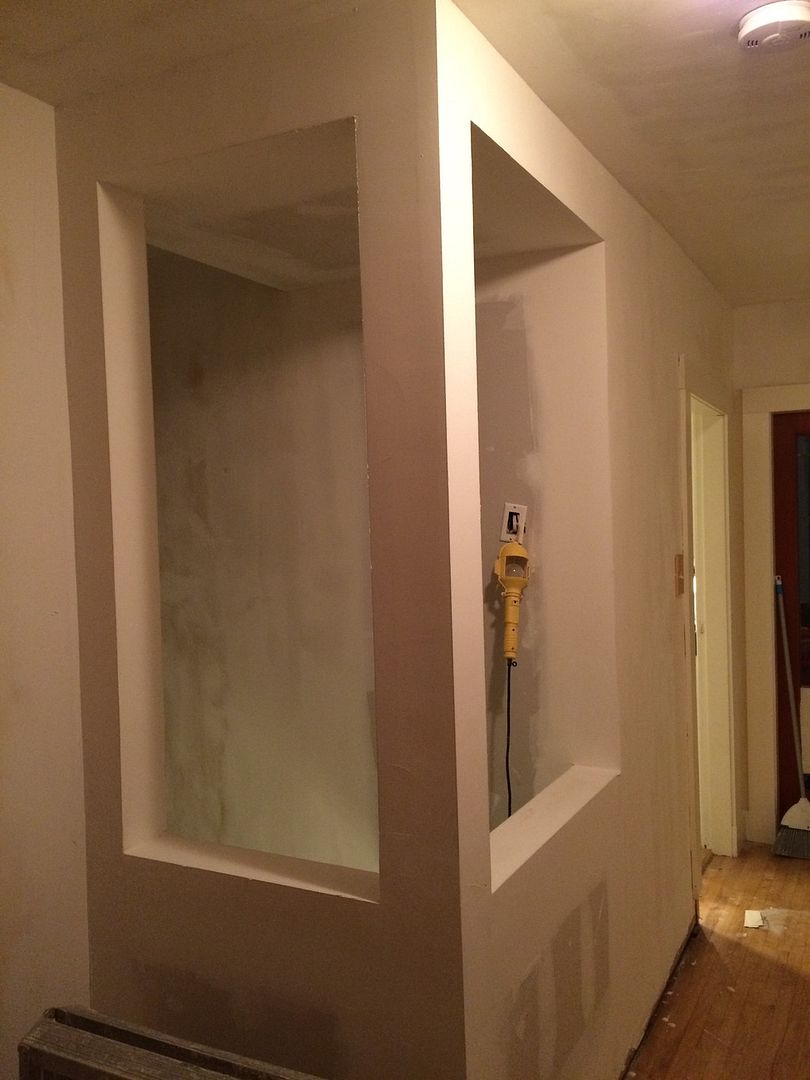

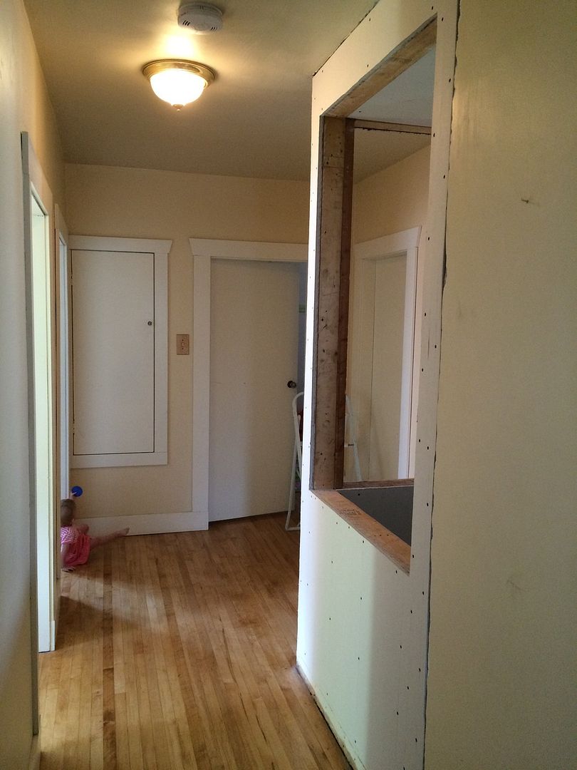

So, we decided to remove that and allow all the warm air up into the living area VS working its way through the kitchen.
This is how it stands right now.

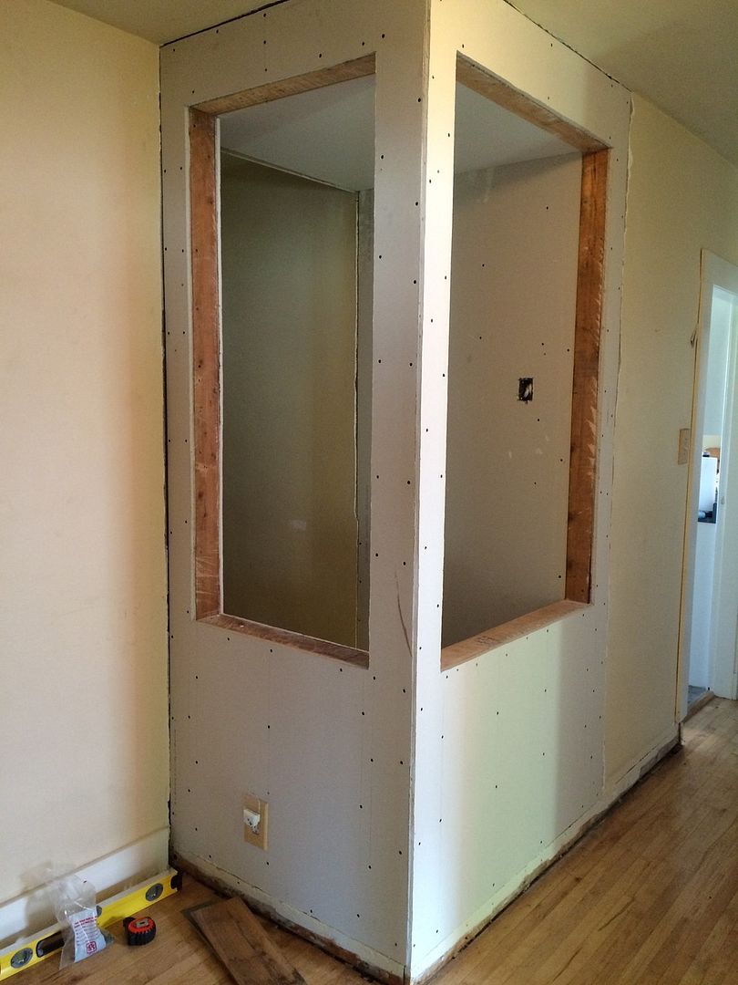

Basically my home is old school browned and plastered walls. No drywall. So I had to shim the drywall out 1/4 with hardboard. I had to shim the drywall to curve it, Follow the original wall. The piece directly to the right is the old chimney Breast.
Luckily I have found a guy who can plaster vs Mudding & taping.
Had the BK running the other night and observed 26C on the Furnace thermos that's in the hall.
Watch this space.

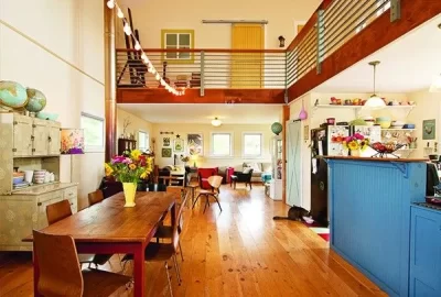

It's just a miniature version of this:

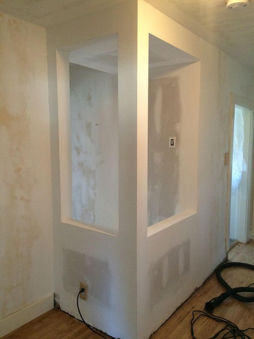

Starting to take shape now folks.

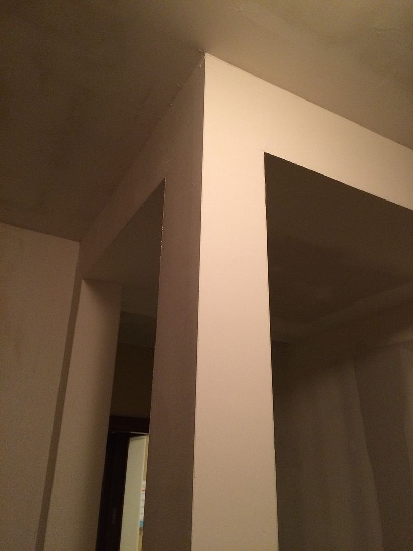

Still undecided, small ceiling fan or pot lights.

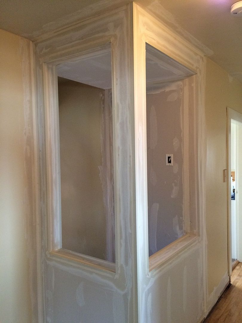

Last coat of mud today.
Gonna start sanding tomorrow.

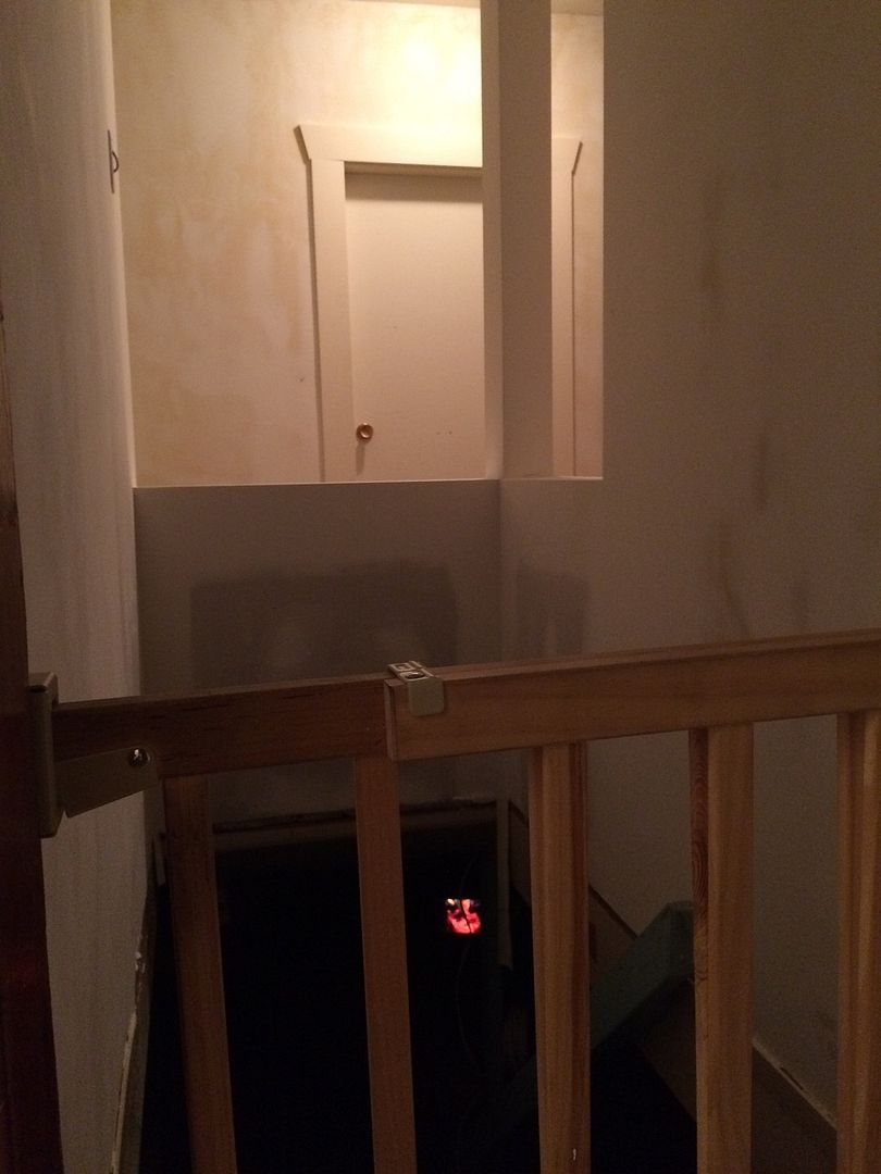

The reason why we cut the holes.
