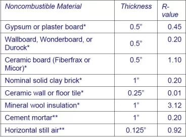

From my Hearthstone Equinox stove manual..
Next question . . . any idea where he could get some Micore or mineral wool insulation? Finding Micore here in Maine is nearly impossible . . . heck just finding contact info is a challenge.
That is in error for cement board and for Micore 300. Micore 300 is listed at 1.03 for 1/2" and Durock or Wonderboard are listed at R=.26. I suspect that list is also the source that Tom used on his site.
Horizontal still air is the bargain there! I would think a raised hearth with a layer of sheet metal followed by a couple layers of durock would work providing the inspector is onboard.. Talking to the building inspector can save you lots of headaches and rework..
Ray
The problem with air is it doesn't support anything. You need structure and that structure isn't compliant.
