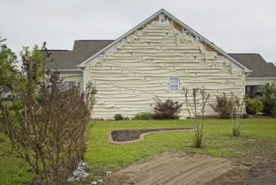

Dunno the answer to that, but I would surely hope your contractor would. I had vinyl siding installed during a big addition/remodel on our house in Virginia, and I never was particularly happy with it, for a number of reasons. (BTW - If you go that way, be really careful not to park a still-hot grill close to the wall after the steaks are done...vinyl melts into some really interesting shapes. :confused:) My house & garage building out here in Bend are clad with fiber cement siding (commonly called Hardie board, but Hardie is just one of a few manufacturers). Fire-resistant, dimensionally stable, paintable, and I think much more attractive than vinyl. Rick

Well, there is that one corner on the back of the garage. Darn stuff should be made anticipating me not watching behind me when I was pulling the big trailer around back instead of the usual small one. ;em Obvious manufacturing defect.
ETA: This place was under roof and sided but not finished in April of 1985. We left work just as a monster hail storm hit. Just three days before I had commented that Fairfax obviously didn't get hail storms since everybody had aluminum siding.
I hauled it straight for the building site the minute it stopped pounding the car. Not one shingle out of place and the siding was primo. The first time a roofer was on that roof was last Saturday when I had it replaced. Two years early according to the roofers.
Most of Fairfax the next day looked like Nagasaki the day after...
No doubt. Just like the spot I turned into modern art by parking my gas grill too close while it was still hot. ;lol

Good to hear you finally got a weather window wide enough to get the roof on. Vinyl is fine as long as you don't apply heat.
