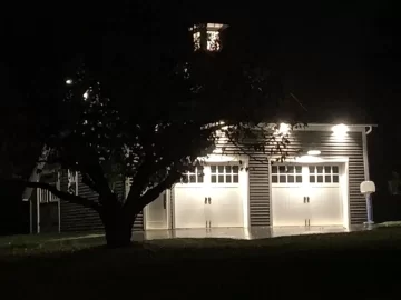

I have seven 40W bulbs on my barn, providing the same or better lighting than one 200W bulb. I’d really encourage you to consider going that way, if at all practical.
It’s pouring rain outside now, as it has been for months, so this was just crudely taken from the front stoop of my house. But this gives you an idea of what 40W bulbs can do, when you put six of them across the front of a carriage barn. The seventh is high in the gable end.
[Hearth.com] RE: You light up my life . . .
I often work out in the driveway in front of that barn at night, and it’s not exactly daylight level lighting, it it’s a reasonable enough compromise between function and look for me. I can’t even imagine having a single 200W equivalent bulb!
