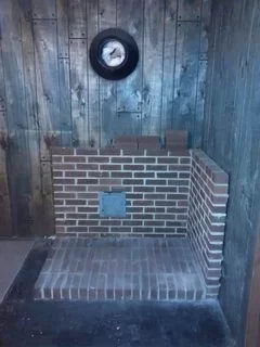

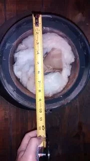

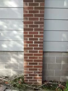

Hi folks,
I'm moving into a new (to me) house and would like to use wood as at least supplemental heat. The house is one story with a walkout basement (1,300 square feet total), and the previous owners had a wood stove in the basement. Almost all of the living space is upstairs. There is an open stairwell that I'm hoping will allow some heat to rise and disperse. A couple pieces of information:
  • I'm in the northern part of the country, so it gets quite cold. -20F is fairly common.
  • I have access to a fairly cheap supply of wood (maple, ash, oak).
  • The house was built in the 70's. It has older windows, and I would classify the insulation as moderate. Not as bad as an old farm house, but nowhere near a modern well built home.
  • The chimney has a clay tile liner.
  • I've added a couple pictures of the current chimney setup to the end of this post.
I'm looking for advice on a reasonably priced, reliable, durable stove that can do the job. I don't care what it looks like. I'm leaning towards something without a catalytic combustor, just because I don't want to have to replace it every few years. I also worry that down the road parts may get harder to find if a manufacturer goes out of business. All advice/pointers appreciated.
Thanks

We just moved to an old farm house and, just purchased another stove. we had a Drolet Blackcomb 1.9cf ( love the stove ) in our other house that worked very well heating it. however we wanted a larger stove for the new place ( larger home no insulation ) so we got the Drolet Balit 3.2cf for the living room and put the blackcomb in the kitchen - dining area. we love it to. lots of heat , very good burn times , well built, and very reasonable price. Drolet make good, reliable , well built, stoves. both of my stoves are non cat stoves. there are many stoves to pick from but , a friend turned me on to Drolet stoves and, I am very happy with the product. my brother in law got a cheap big box store stove and he is not happy. get a insulated stainless steel 6" chimney liner and you should be good . good luck with your project .

The Englander 30NC is a popular inexpensive heater with large capacity. Is the brick hearth on a concrete slab? Another alternative would be the Drolet 3 cu ft stoves.
Thanks for the recommendations begreen. Yes, the bricks are sitting on the slab.

And don't forget to have that clay liner inspected for cracks, etc.
You may find you will need a liner.
Heating from a basement can be tricky (and disappointing) unless it is the basement you want to heat.
The open stairwell may or may not transfer heat to the upstairs. Depends.
Is the basement ceiling insulated? If it is, then most of your heat will just stay in the basement. If it is not, then you will see some benefits on the living space in the form of warmer floors.
