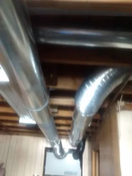

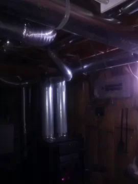

It's hard for me to identify from the pictures, but I'd also look again into your ductwork. Not only does it look like your hot supplies might be inadequate, but even if they are ok, best I can tell it looks like you have a single, long, 8" round cold air return duct? If so, that's also very inadequate.
I agree with a previous suggestion that you might want to have a reputable HVAC guy come take a look. Even if he doesn't know about wood furnaces, just tell him 900 cfm and that should be enough for him to tell you how to change to ductwork to not be the problem.
For example, it sounds like the 8" outlet ducts are unbalanced; one has 2 runs and the other has 4. It would be an improvement, (but not quite a total solution), to dump both 8" outlets into a small box, then take more runs off of there. At least the airflow through the furnace will be balanced and you'll pick up a lot more heat that way.
I had trouble trying to get one 8" to the end of my house that's why I have 4 coming off that one I have a split level it was hard to do
Yeah, with that long of a run I'd say they need to be upsized...and probably insulated too, there's a lot of heat and velocity lost on a run that long...
Can you try unhooking the ducting from the top all together & see how much heat it puts out then? As a test. Finding it hard to get the whole picture of what you've got going on there.

...or unhook the 8" 'uprights' from the trunks, leaving only stubs/stacks.
Kinda hesitant in saying that as I'm not sure what all you have going on there (supply and return), and wouldn't want to get into some kind of safety issue. All kinds of potential for things/details to get lost in internet translations...
[Hearth.com] real thinking about taking out my drolet heatmax more pictures of the furnace set up the 8 " on the left is running to the end of my house the other on the right is my cold air return. The other 8" coming from my furnace is t off one going to my kitchen and one to my living room

Also, just FYI, that flex pipe you used on some of your bends has really crappy flow characteristics for this application, that definitely is not helping matters here...
That what im to figure out. I was talking to SBI about the set up they said i have to much static pressure on the duct that is only one going to the living room and the kitchen because its the closes ones to the furnace is that the trouble
That's why I suggested to install dampers in each run and/or adjustable/close-able louver register covers so as to be able to balance things as needed. Too much SP means the ducts are too small/too many bends/too long (also flex pipe) as I said in my last post. Installing a smooth running heating system is more complicated than it looks, huh?!
