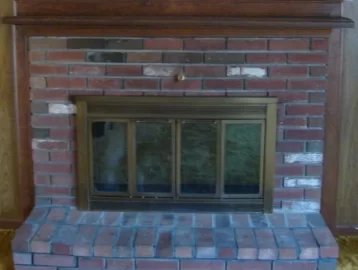

Hello There,
I've been considering an insert or hearth-mount stove for our masonry fireplace, and I've decided on a hearth-mount for noise, power, and looks reasons.
In any case, the hearth is only 16" deep. Any recommendations on stoves that would work for this? I have seen the Hearthstone Tribute and Homestead stoves, which seem nice, but I'm not sure about soapstone.
Thanks!

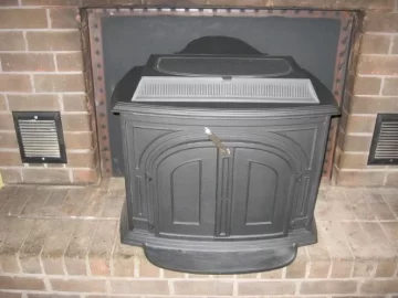

I had a similar situation with removing an insert and installing this VC Vigilant. I recessed the backplate just to the backside of the bricks.
What did you put down for floor protection in front of it?

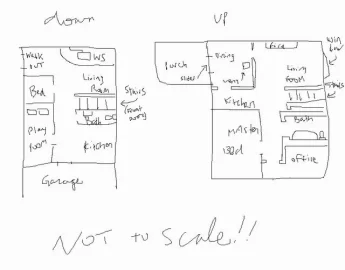

Sorry, I missed that info! Top floor of a split, about 1,200 square feet with great insulation and a woodstove in the basement. Since we have electric heat, the rooms on the other side of the house will be independently controlled. See attached diagram (sa-weeet!). The stove location is marked "fire" upstairs. I haven't measure the fp yet.
SML

My installer built me a tile/durarock hearth extender that matches the stove. I've actually pulled the stove out to where the legs are about 1 1/2 inches from the end of my current tile hearth. The extender rests up against the legs and extends about 18 inches. I'm thinking about adding a layer of 1-inch kaowool to the bottom to protect the floor from scratching any more than the 85-year-old floor already has.

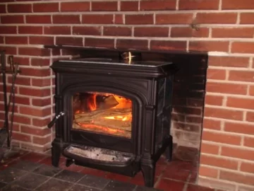

Consult an installer about how to configure the connection from the flue collar to the flue liner. We had to mess around with ours a bit to make it work. Also, a stove with a vertical flue collar setup is going to be tough to work with. You'll need a rear-exit option or a 45-degree like my Phoenix. Finally, watch the height if the depth of the stove forces it under the lentil. You're going to need some space to work and some visibility to the stove pipe or flue liner thermostat. Good luck!!!
