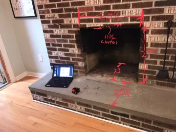

Hi all!
Below is my fireplace with an 11.5 inch lintel, located in the centerish of my 2 story home (around 3k sq ft). Because of this lintel limitation I only have a few options of rear venting wood stoves and 1 or 2 wood burning insets on the market. I ordered a VC Encore about 8 weeks ago and was just told today that it will be another 8-10 weeks. I called a local vendor and they have a few Jotul F 500 V3 CF with short legs available, ready to ship this week.
My question to you, the Hearth.com community...is the Jotul worth an additional $1,500+ over the Vermont Castings Encore? $4430 vs. $2899.

It is a new model with an unproven design so honestly we have no idea at all. Why not just an insert?

I have to say, at this juncture, none of the above. The new F500v3 has had some birthing pains that we await resolution. The first season for some users was not too good for some owners. I can appreciate the desire for a good looking stove at this point, but I would go for something else if available. Reliability is important. Have you looked at the PE Alderlea T5 insert? That is a simpler design with a good track record. In hybrids, the Hampton HI500 is worth looking at.

A top vented insert may work. Take a look at the ones suggested. The T5 insert is about 21" tall and about 18" deep, so the depth at 21" is what is important. If it is close, some of the rear top brick can be carved out for the fit. The Hampton HI500 is about 23.5" tall and about 19" deep, so the depth at that point is what's important.

Thank you for this. Do you know if these are rear venting options?
Inserts don't rear vent they sit in the fireplace and top vent
I should have been more clear here. An insert with a top vent that is at least 12" back from the faceplate.
meepmao3912
This is incredebly helpful and I will look into these. Thank you so much!
