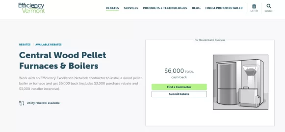

Now I can shut the stove off most days while at work for 6-8 hours, and I monitor the temperature remotely and start the stove so it will be sufficiently warm by the time I get home. A little more work, but I can save a bag of pellets every 3-4 days. It could save a ton over the season. We shall see.
If it wasn’t comfortable before and was totally hopeless, and if the added insulation now helps enough to where spending a little more makes it comfortable, then those people will probably spend that extra.
If it wasn’t comfortable before and still isn’t even close, then those people will probably still spend whatever they got the budget for, and have some relief not freezing quite as bad.
In Vermont you can get $6,000 back on the installation of a pellet boiler. I just don't like the cost of pellets approaching $7 a bag and rising (like everything) yearly. I'm sticking to free wood.I know the price of free!
Screenshot 2023-01-09 at 09-21-46 Central Wood Pellet Furnaces & Boilers Efficiency Vermont.png
