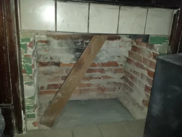

My question is about the main Fireplace. I have a double-sided chimney with two fireplaces back to back in separate rooms. I am in the process of installing wood-stove inserts for heat because Mr. Patches threw some old gas logs in them and called it a day. They did okay at warming the room that they were in but they smelled bad and put out tons of soot. The gas furnace is also no help because Mr. Patches installed duct work by dragging it underneath the house on dirt because of the lack of a crawl space and as a result, most of it was torn in half. I also found this out after digging under my house. So I'm in the process of fixing that too. But for now, I'm installing the two fireplace inserts; one is a Buckstove model 50 and the other is a Blackbart II. I have installed a stainless steel flue and found that my stove wouldn't sit back far enough into the box to connect to the flue. My original fireplace was only 28"x28"x17" (at bottom) and 12" (at top). I took out the firebox which gave me up to 37"x28"x21.5" (at bottom) and 17" (at top).

What firebrick should I get and where is the best place to get it?
What mortar is best for my old house?
Are firebricks just as strong as regular bricks because it looks like the brick I removed is a part of a layer that keeps going up into the flue.
Can someone explain the air gap principle to reduce distance from combustibles? (I'm going to have a few inches of free space on each side once complete but my fireplace is only two bricks thick and then I have wood after that)
