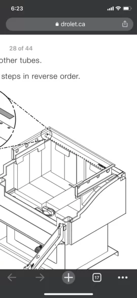

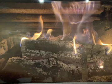

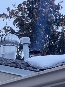

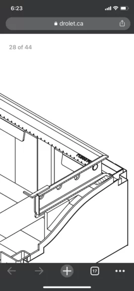

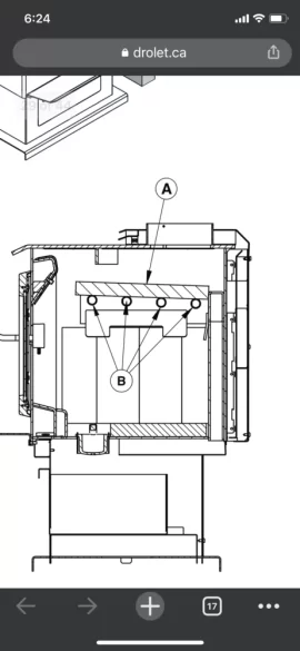

Hey guys,
Yesterday I pulled the front 3 reburn tubes in my Drolet escape 1800, dropped the baffle , and cleaned my flue (it was pretty good btw 😁). After I was done, I reassembled per the manual , and the last couple of fires it seems I’m not getting enough secondary activity, and I’m definitely burning dirtier. (See photos - chimney photo is about 45 minutes after startup).
It seems like the center of the tubes are not reburning much at all. Fire behavior seems inconsistent as well, not taking off like it did before. I pulled the tubes again tonight, inspected, and reinstalled with the same results.
For reference, same wood I was burning before. For the most part sub 20% mc pine .
Any ideas?

Hey guys,
Here’s an update for anyone wondering:
Took all the secondary tubes and baffle out, inspected the secondary air passages with a bore scope, all looked normal.
Cleaned the stove out, as I had quite a bit of ash in the bottom. Found my boost air holes blocked up, so cleaned those. It seemed like the ash was very packed down from my previous flue cleaning activities.
Fired it up, and it’s burning normally again. I’m thinking that between my boost air being plugged up, and the ash in the bottom being very packed, I may have just been starving for air, which explains the dirty burn.
Does anyone know how the primary air actually enters the firebox on these? I can’t seem to figure that out exactly.
I’ll post again if something changes. Thanks for the help everyone.
Right above the window on the stove face
