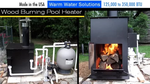

I dont have pictures of my exact setup, but can find some very similar ones online. Its basically a vertical rectangular prism, with the bottom section being where the logs burn and the top half being where the tubing runs. and then a chimney stack. I was pretty much just thinking getting a dryer hose that was half the diameter of the chimney and routing it into the door.
[Hearth.com] Recirculating chimney exhaust back into stove for more heat?
Agreed that these setups look pretty inefficient with a lot of heat lost up the stack and perhaps no secondary combustion. A reburn system would help, but not as described using dryer vent.
