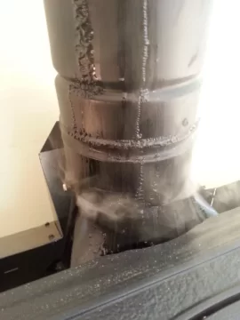

Thank again for the help with the stove, we decided on a Jotul F500 and had it installed by ACME Stoves in Charlottesville VA . This was supposed to be a victory message however we just can't get it to burn, the stove just wont get over 300 degrees. When we move the damper more than halfway open smoke starts to pour into the house where the stove connects to the pipe. This also happens whenever the secondary burn kicks in momentarily and seems to just put it right out. When I open the door the wood bursts into flame and promptly goes right out when I close it, smoke pouring into the house from the pipe. I contacted Jim with ACME and he adamantly said that I had unseasoned wood. The wood I'm using now is Poplar that was split last year and is stored covered off the ground with a moisture meter reading of right around 15%. He also stated that moisture meters were horribly inaccurate, which I won't dispute but the wood appears dry, sounds hollow when I hit it together, doesn't hiss and when I open the door it bursts into flame. What am I doing wrong, should the smoke and liquid creosote be coming out of the pipe there and why won't it fire?
