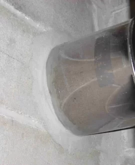

12" thick concrete foundation wall?? Sounds a little 'un-orthodox'... Sure it isn't ten inches???
Here's a picture of the 6" (8" O.D.) pipe going through the 12" cinder block wall.
