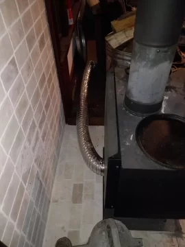

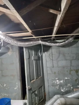

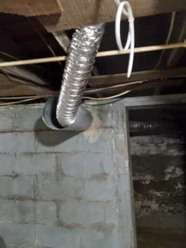

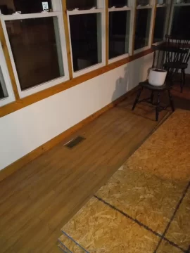

Made a redneck halfway oak kit out of some flexible ducting I had laying around. It goes down to the basement and rums into a duct going to a floor register in a unheated 3 seasons room. Think it'll make any difference?

If the three seasons room is not so tight, it'll work. In principle. (And make that room colder.)
However, it is rather long, which may impede draft and make things worse - smoke rollout etc.
If the basement is not very tight, why not terminate there? That'd make the basement a bit colder but keep your stove room warmer

Nothing on this house is tight. Or square for that matter. The 3 seasons room gets much colder than the basement. it has 14 windows and a sliding glass door
A long pipe has more resistance to air flow. Try blowing on a toilet roll thingies or your garden hose.
So yes, a long oak will breathe less easily.
What is long and what is too long? I don't know. But if you have any smoke roll out, I suggest this is the reason.
If so, I'd simply terminate the oak in the basement.
I presume the duct is all metal (no plastic)?
Yes no plastic. It was old ducting I had laying around so if it causes problems I'll disconnect and move on lol. Didn't cost me anything. Figured it might be good for a degree or two of house temp though.
