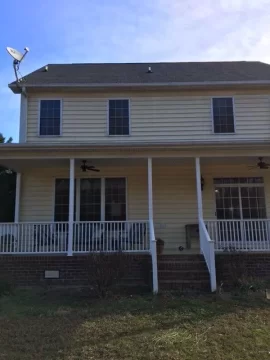

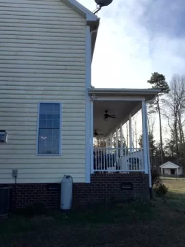

So after the number I got we're rethinking the location of the stove. By moving it I think we can reduce the material cost and have my general contractor husband do the install. The original location puts us near the roof apex translating to a more difficult install + more material. I'm thinking a corner stove with the flue going where the useless dish is now. Seems like it could work. Will require I move around furniture, what stoves would have less clearance requirements? I read on here some brands...BZ was one.

Hi LTea.
I installed my own chimney.
I did a duravent thru wall and up around 27 feet 4 yrs ago.
Materials where around 1200 and i just added a cheap 350 dollar stove and ran that till just recently.
I did have to rent scaffolding to do it but its doable especially if you have a GC in the family.
As far as clearances look at Pacific energy, one of the reasons i bought one.
BeGreen is spot on. Consider the extra length of chimney and black pipe a great investment. Keeping the chimney within the envelope of the home will keep it warmer and help considerably with draft. If you purchase a highly efficient appliance, you will not regret dealing with the "more difficult and material install".
