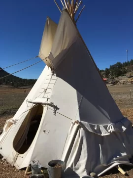

A tipi! Can you post a few pics? Sounds interesting. Especially at 7000' . Where are you at roughly in the state?

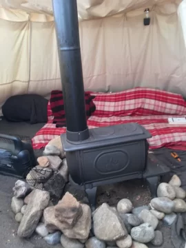

We are in the San Juans.
This is our setup as of right now.

Nice area. No offense but it's gonna be a looooong winter feeding that stove. Keep us posted on how it goes.

Spent some winter nights in a friend's tipi in CT many years ago. He had an Ashley Columbian setup like this. It worked, but come midwinter I was glad I had a cabin to return to.
