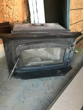

Hello Folks,
I've been looking at an old slammer style insert recently with the intentions of adapting it to a insulated chimney liner. I've been steered away from it by folks on here suggesting a more modern higher efficiency insert. l've found a Regency insert locally (possibly a 2400) at what seems to be a really good price. It looks like there has been quite a bit of positive feedback on Regency 2400's on here over the years. Do you folks still recommend them? Do you agree that the one pictures appears to be a 2400?

Looks like one. Is the rating plate located under the ash lip?
That's tell ya for sure...
Only thing I can say is that my brother has the free-standing 2400 and it appears to be a quality unit. His has burned many years with no problem, and if it ain't broke, he ain't gonna fix it..especially if he would have to spend money. He even made his own blower, when he saw the price of the one from Regency.
You'll need to look closely at the stove for any signs of over-firing.
Open the door & look at the corners of the opening.
If there are any cracks, that's one indicator of excessive heat.
Also look at the condition of the secondary air tubes.
They should be relatively straight with no signs of warping...
Overfiring sometimes shows up as a greying or whitening of the paint above the door. This unit looks pretty good so far. There appears to be a firebrick loosened or up in the front bottom of the stove. Check the firebrick condition too. How much are they asking for it?

Should be a UL sticker with manufacturer info on the front of the stove where the blower would slide in under the door. It should have the model number and serial number along with other info.
The one picture I see looks pretty good. You may need to replace the brick but that's normal wear. Make sure the baffle panels are above the burn tubes and they're not broken into pieces. If you want to remove a tube you need a pair of vice-grips and a hammer but they come right out.

It will need some firebricks replaced, but if there are no cracks or popped welds and the tubes look good then snap it up. That's a very good deal.

Ok, finally was able to get this insert bought this morning for $150. I didn't see anything that I felt was obvious over firing damage. The front secondary tube is bowed a bit in the middle which I assume isn't factory, but it didn't seem like something that would be a problem. Here are some additional pics I took once I got it home. Looks like it's listed as just a medium insert on the tag. Is this an early version of the i2400?

Doesn't look too bad for $150. >> If you can, put in a new burn tube, replace a few bricks, and see what she does. ==c Not sure about the age. Maybe Regency can tell you, based on the serial number..?
Well, looks like the model for this is an R14 Medium Insert. Again, I assume it was a predascessor to the current i2400. The burn tubes appear to be welded in place unlike the current model with it's removable tubes.
Sent from my XT1254 using Tapatalk
Great, that's $50 less than expected. To perform well then insert could use a little loving, but it may be good to go. Before installing I'd consider cutting out the secondary tube and having a new stainless tube fitted. And I'd get the blower fixed or the motor replaced. That and a couple firebricks should have you set for a nice heating experience.
