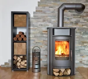

The damper was opened fully when I noticed it leaking. The chimney was recently installed so I don't think there would be any obstruction, like a nest, in there. The pipe is at an angle before it goes through the wall similar to the pic attached. I just found this pic on the internbet. I would have attached a real pic if I were at home. Maybe there are too many angles on the pipe

This promo piece shows a sub-optimal chimney connection. There are three 90º turns for the smoke coming out of the stove within about 6 ft. It may look tidy, but this configuration will be prone to problems unless connected to a 30 ft tall flue. It should have been done with a 45 and 90º elbow. If your stove is connected like this, I would change it. Post a picture when you get home.
Will do! The first angle is not quite as sharp as in the pic.
